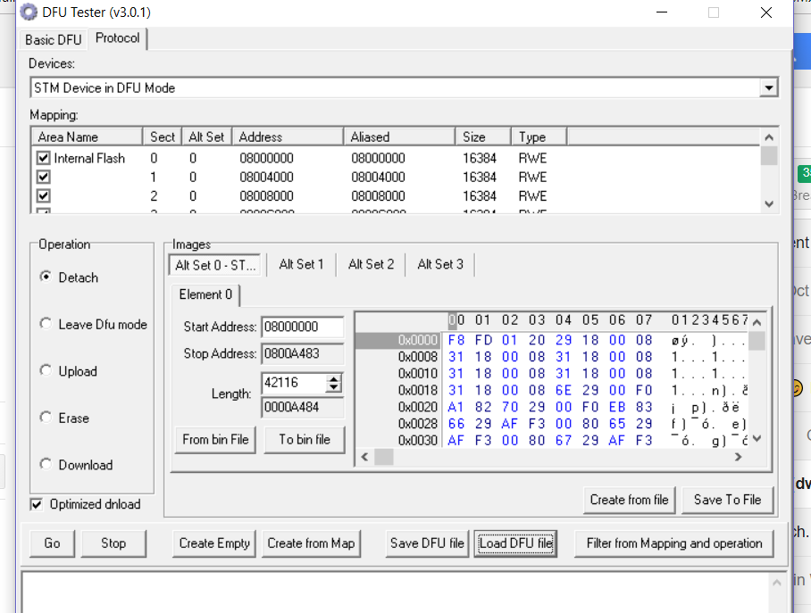

If the board is in “Boot mode” Step 1 and If the STM DFU tester can’t see it then my solution won’t work.
The tester should look like this if the device is in boot mode. I am sure your device must have a hardware issue?
