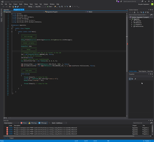

I use the same references as the example but the type PWM is not being found:
What I’m doing wrong?

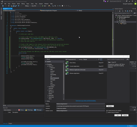

I found the solution for my problem.
If I create the project as a netduino application the PWM type is working good.
But as the getting start page says, to create a console application and even “include” the same using variables, the PWM type wasn’t found.
Maybe there is something wrong in my installation. But if I select a netduino applicaiton it will work just fine.

What references do you have included? I’m guessing you’re missing SecretLabs.NetMF.Hardware.Netduino.
Yes, Bryan is right, you can do it if you include all the references that you are “using”.
