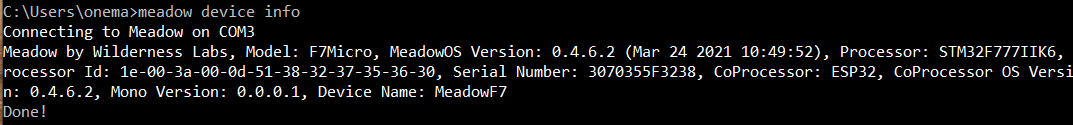

Do you get any output when you run the command meadow device info
At first I got an error, it said
Value cannot be null. (Parameter 'PortName')
So I tried the following command:
meadow device info -s COM3
and this is the result:
Well the good news is that you can communicate to your Meadow on COM3.
Here is my output for the same command
Connecting to Meadow on COM3
Meadow by Wilderness Labs, Model: F7Micro, MeadowOS Version: 0.5.1.0 (Jun 19 2021 01:49:23), Processor: STM32F777IIK6, Processor Id: 38-00-41-00-0d-51-38-32-37-35-36-30, Serial Number: 307735793238, CoProcessor: ESP32, CoProcessor OS Version: Not available, Mono Version: 0.5.1.0, Device Name: MeadowF7
Done!
