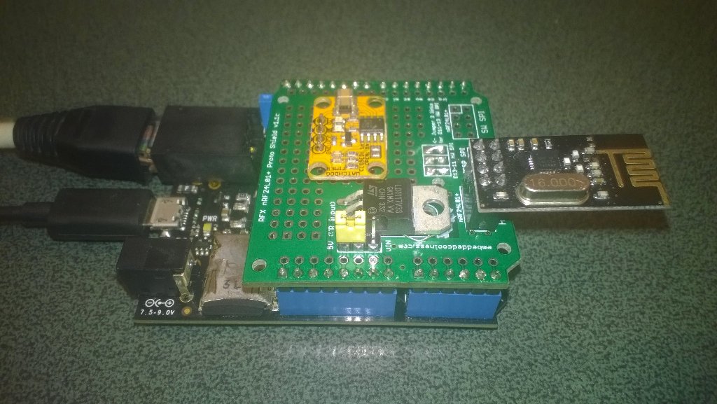

I have a couple of nRF24L01 on RPI2/3 (AdaFruit.IO & Azure IOT Hubs) & N3Wifi (AdaFruit.IO) based field gateways for *duino devices (currently telemetry only) which might not work for your application
A watchdog fitted to the Netduino based field gateway helps a lot with uptime…
