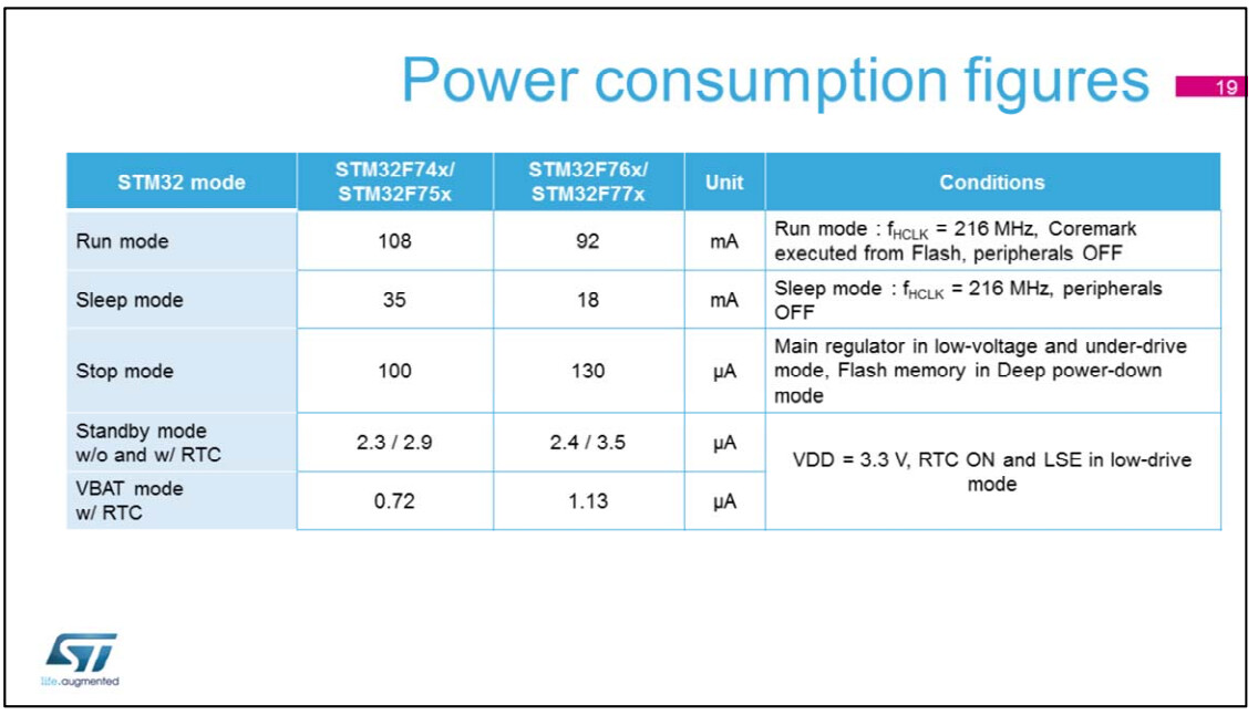

Assuming I’m reading the STM32F7 docs correctly, this should be possible:
https://www.st.com/resource/en/product_training/STM32F7_System_PWR.pdf
https://wiki.st.com/stm32mcu/wiki/Getting_started_with_PWR
It appears that nuttx has support for the Stop mode and the Standby mode. What does it take to get these available in Meadow.OS? Also when in sleep mode do the other co processors go to sleep? The document above claims 18 mA in sleep mode but I was seeing 31 mA. That seems a little more than just power loss due to voltage converters. Seems like other components on the board aren’t sleeping.

@michalsteyn It does not look like this is possible with the current version (1.3) of Meadow.Core. The STM32F7 does have that ability and it appears to be available in Nuttx OS (stm32_pmsleep.c), just not yet implemented in Meadow.Core.

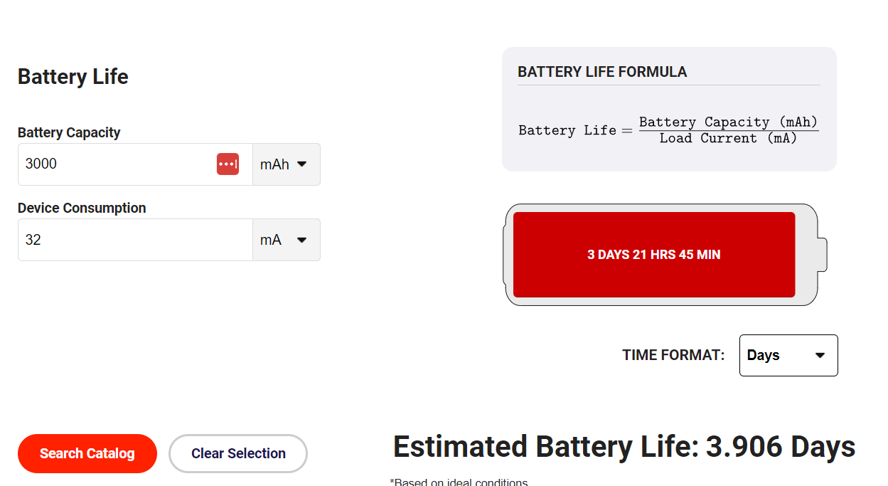

If your project is anything like mine you’ll need a bigger battery than you think and/or a solar panel until Meadow fixes/adds other “sleep” options. At my tests of 32mAh power usage during sleep, that would only get a few days on a 3000mAh battery.

https://www.digikey.com/en/resources/conversion-calculators/conversion-calculator-battery-life
